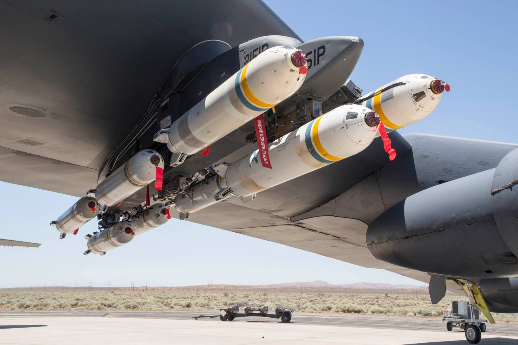

Příspěvky: 11304
Re: Letecké bomby
Příspěvek od skflanker_ » 15 říj 2017, 17:53
Grafitové bomby / submunícia
Grafitová bomba / submunícia sa používa pre vyradenie elektrických vedení / rozvodní z prevádzky. Obsahuje zvitky uhlíkových vlákien ktoré sú elektricky vodivé a tým na elektrickom vedení spôsobia skrat, na ktorý reaguje každá ochrana vedenia a vedenie / rozvodňa sa vypne. Pokiaľ sa z vedenie neodstránia všetky tieto vlákna, nie je možné zapnúť. Neúčinkuje to na izolovaných vedeniach - tie sa ale používajú veľmi výnimočne.
Submunícia:
Submunícia BLU-114/B
Video z bývalej Juhoslácvie kde sa to bežne používalo:
https://youtu.be/QY904Uj859g zverejnené 11.04.2009, dĺžka videa 0:30 min.
Popis z videa:
A graphite bomb (also known as the "Blackout Bomb" or the "Soft Bomb") is a non-lethal weapon used to disable electrical power systems. Graphite bombs work by spreading a cloud of extremely fine, chemically-treated carbon filaments over electrical components, causing a short-circuit and a disruption of the electrical supply. The filaments are only a few hundredths of an inch thick and can float in the air like a dense cloud. The weapon is sometimes referred to as a "soft bomb" since its effects are largely confined to the targeted electrical power facility, with minimal risk of collateral damage. The graphite bomb was first used against Iraq in the Gulf War (1990 - 1991), knocking out 85% of the electrical supply. Similarly, the "BLU-114/B" graphite bomb was used by NATO against Serbia in May of 1999, disabling 70% of that country's power grid. After initial success in disabling Serbian electric power systems, the electric supply was restored in less than 24 hours. The BLU-114/B was again used a few days later to counter Serbian efforts to restore damage caused by the initial attack. In the later stage of Operation ALLIED FORCE, NATO airforce used conventional bombs and rockets to target power highlines and transformer stations. Graphite bombs only work on power lines that are not insulated. Most recently, it was used in the Iraq war to cut radio contact on an Al Queda outpost outside of Bagdad on December 15, 2007.
Grafitová bomba (tiež známa ako "Blackout Bomba") je ničivá zbraň používaná na vypnutie elektrických systémov. Grafitové bomby pracujú šírením oblaku extrémne jemných, chemicky upravených uhlíkových vlákien nad elektrickými komponentmi, čo spôsobuje skrat a poruchu elektrického napájania. Vlákna majú hrúbku iba niekoľko stotín palca a môžu sa vznášať vo vzduchu ako hustý oblak. Zbraň sa niekedy označuje ako "mäkká bomba", pretože jej účinky sú do značnej miery obmedzené na cielené elektrické zariadenie s minimálnym rizikom vedľajších škôd. Grafitová bomba bola prvýkrát použitá proti Iraku vo vojne v Perzskom zálive (1990-1991), čo vyradilo 85% elektrickej energie. Podobne bola v máji roku 1999 NATO proti Srbsku použitá grafitová bomba "BLU-114 / B", čím zablokovala 70% elektrickej siete tejto krajiny. Po počiatočnom úspechu pri zakazovaní srbských elektrární bol elektrický zdroj obnovený za menej ako 24 hodín. Modul BLU-114 / B bol opäť použitý o niekoľko dní neskôr, aby vybojoval srbské snahy o obnovenie škôd spôsobených počiatočným útokom. V neskoršom štádiu operácie ALLIED FORCE používali letectvo NATO konvenčné bomby a rakety na zacielenie vysokorýchlostných a trafostanicových staníc. Grafitové bomby pracujú iba na elektrických vedeniach, ktoré nie sú izolované. V poslednej dobe to bolo použité v irackej vojne na zníženie rádiového kontaktu na základni Al Queda mimo Bagdadu 15. decembra 2007.

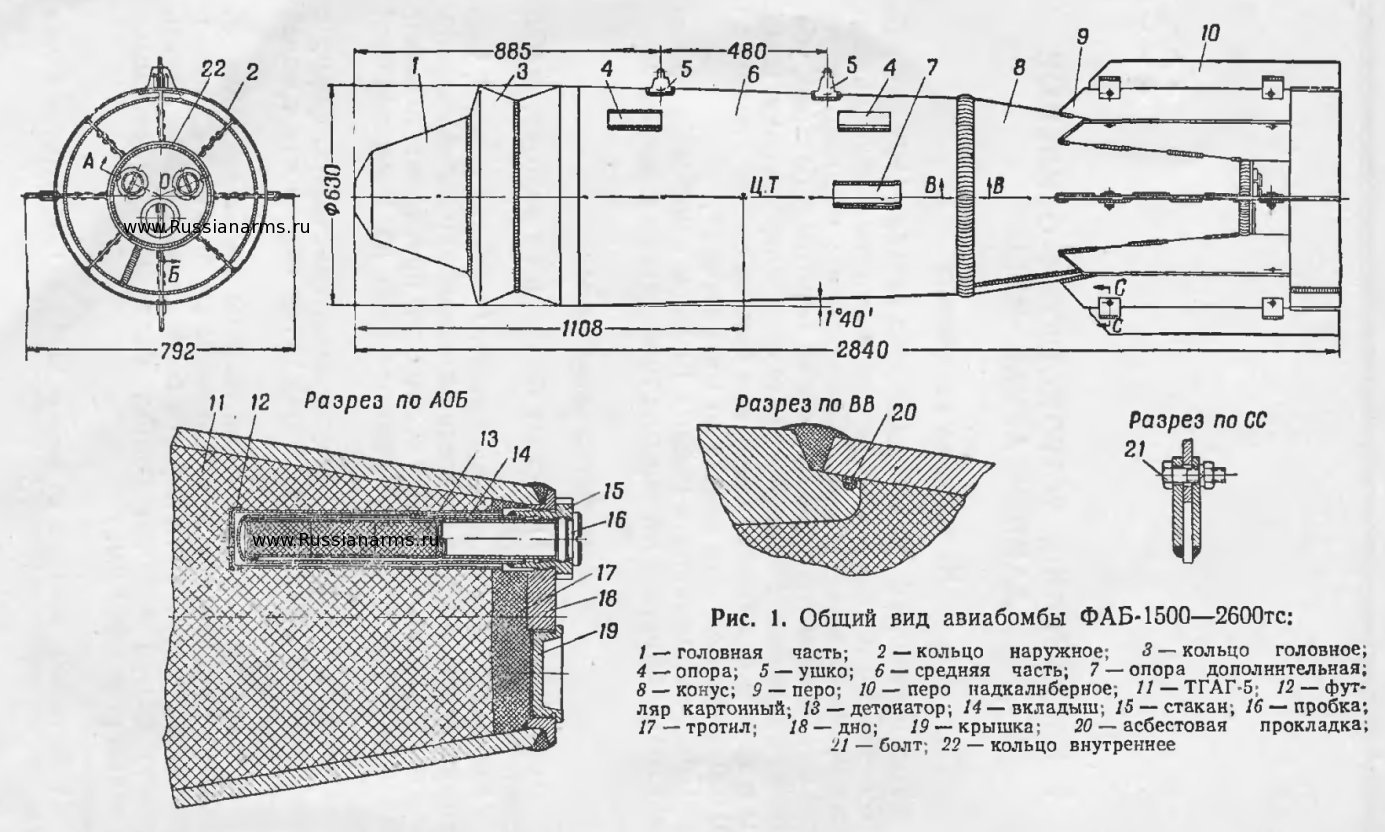

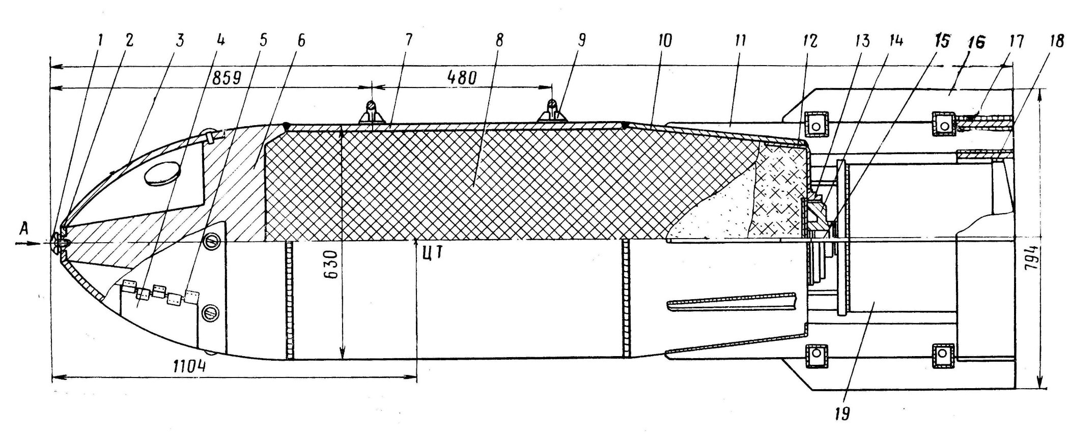

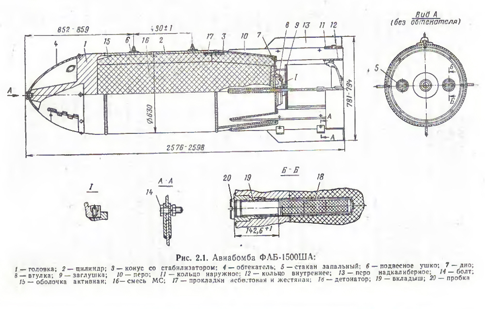

Příspěvek od Alchymista » 26 lis 2017, 23:25
Sovietske a ruské letecké bomby ťažších kalibrov
FAB-1500-2600TS
FAB-1500ŠA
FAB-1500Š/ŠA

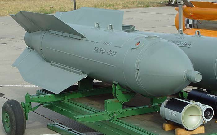

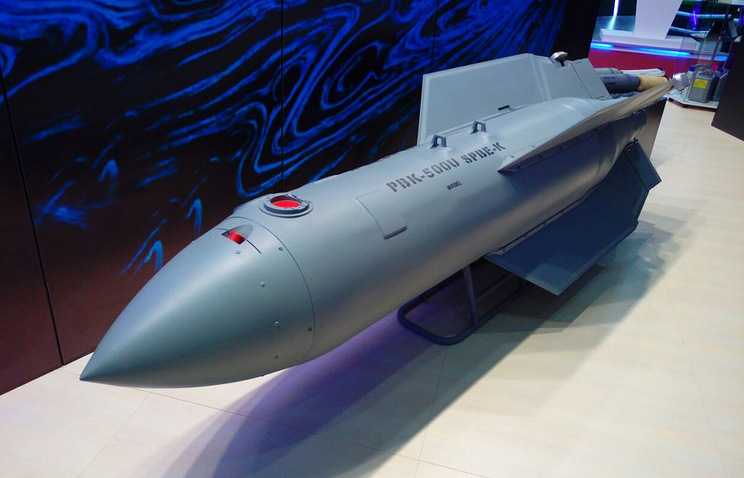

Příspěvek od skflanker_ » 08 led 2018, 19:27
▲ ide o bombu PBK-500U SPBE-K "Dreľ" (ПБК-500У СПБЭ-К "Дрель") (Dreľ / Дрель = vrtačka)
PBK-500U SPBE-K (ПБК-500У СПБЭ-К)
PBK-500U SPBE-K (ПБК-500У СПБЭ-К) a submunícia
PBK (ПБК) = "Kĺzavá" kazetová bomba (Планирующая бомбовая кассета) (zatiaľ takú kategóriu nemajú ani na wiki)
RBK (РБК) = Jednorázová kazetová bomba (Разовая бомбовая кассета)
PBK vychádza z RBK s tým že má kĺzavý let navádzaný pomocou Inerciálneho navigačného systému + doplnený o GLONASS
